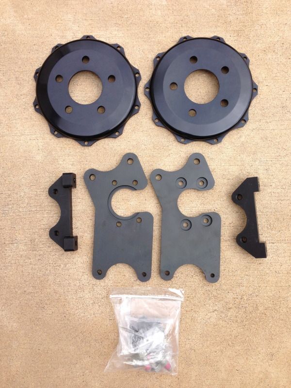

Here is the rear brake conversion kit to run a 345x28mm rear rotor with 4 piston Brembo caliper with. This is the kit that I picked up from Brian a Fiveology.
I am excited about getting the brakes on the car. It is going to look bad ass.

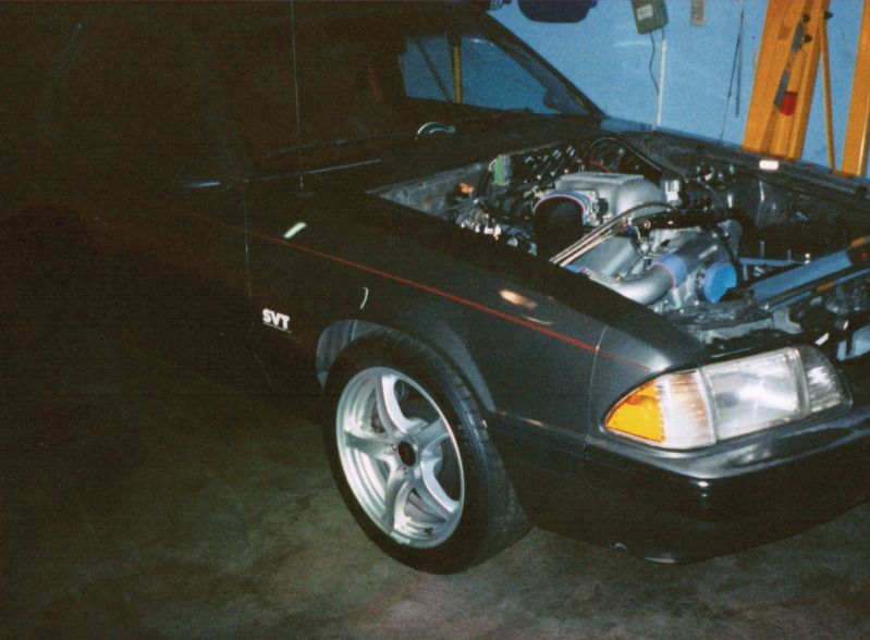

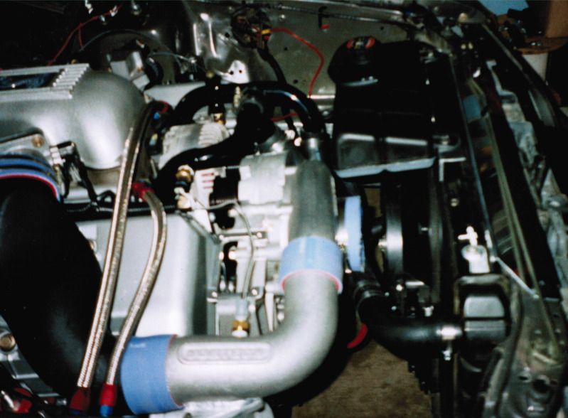

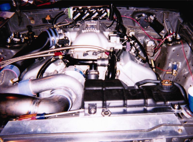

I thought I would add some photos from 1999. This was my first modular conversion and one of the first in the country as well. It was more of a drag set up. I ran the car in FFW Modular class until they changed the rules to only allow SN95 cars. That's when I pulled this one apart and built a 98.
Test fitting the motor in for the first time. I used a Tubular K Member for a 96-98 modular car and modified it to work in the Fox Body.

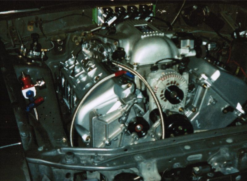

This was one of the first T Trim superchargers ever mounted on a 4.6 as well. There was not even a kit. It used the S Trim kit and had the head unit separate.

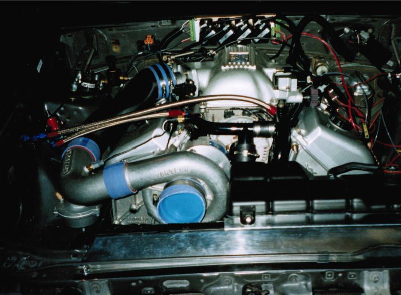

The cold air intake came out awesome on this build. One of my favorite items when it came to fabrication (although I didn't weld it). I bought everything from a diesel supply as this is 5" Exhaust tubing.

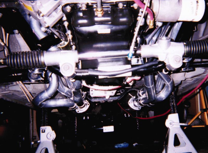

There were no headers for this build back then either. I got these from Sean Hyland. Again they were for a 96-98. They didn't even clear the Lakewood bellhousing. Had to trim here, cut there, until I got it to fit. Had to modify one header tube to clear the steering shaft. The primaries were 1 7/8" which caused big clearance issues. Ended up pinching some of the tubes down to get it to fit. Nothing like taking a hammer, cut off wheel and a welder to a nice set of ceramic coated headers.

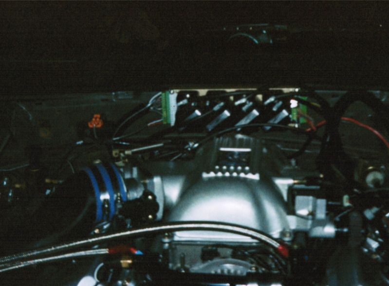

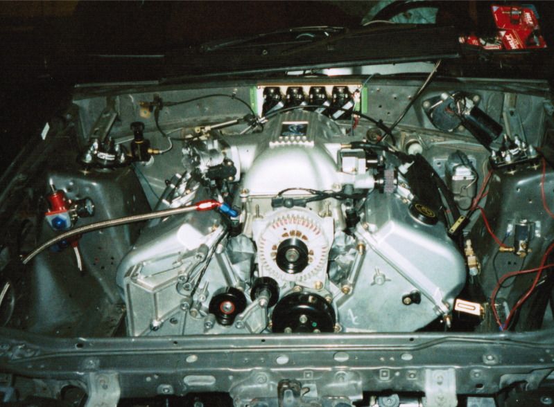

Picture of the Electromotive ignition. It sucked even back then!!! I hated that thing with a passion and trying to find someone to tune it proved almost impossible. Luckily after going to some races I met up with John Mihovetz from Accufab. He is an awesome guy and smoothed out all of my tuning issues as well. He even gave me a lot of pointers on how to do things better on my combination.

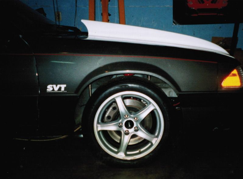

Here is the 4" cowl hood. Totally unnecessary but I thought it looked cool at the time.

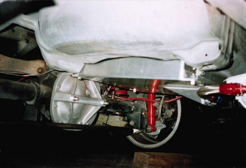

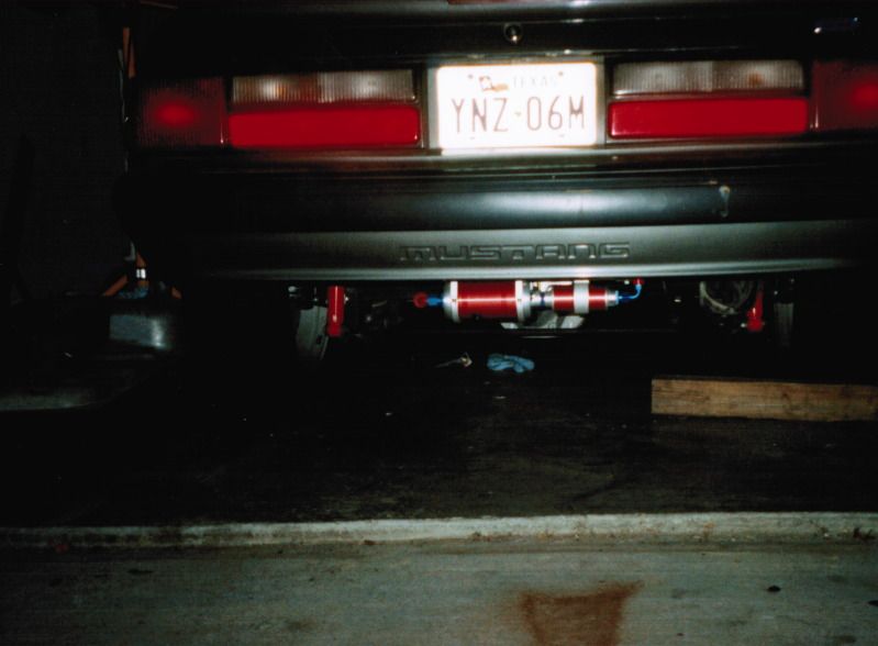

My fuel system
