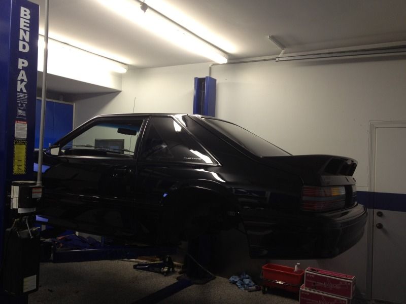

Here is the car missing some parts

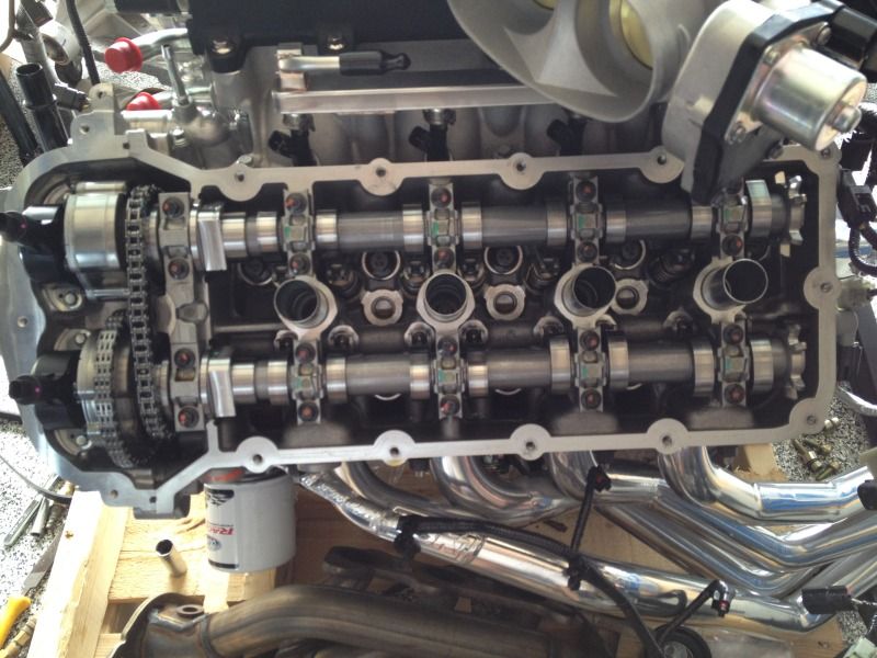

Here are some random shots of the engine with the covers off.

Its very nice(clean) garage,(seen it when I picked up parts)drkhrse wrote:I keep looking at your garage, so nice and clean! I have a Benpak 4 post lift, love it! I want a 2 post as well.
But if you look real close you see he missed a spot. Dam blue brake Fluid.
I know where all the missing parts are !!!
almost have them all detailed and ready to go in car.

casper wrote:Its very nice(clean) garage,(seen it when I picked up parts)drkhrse wrote:I keep looking at your garage, so nice and clean! I have a Benpak 4 post lift, love it! I want a 2 post as well.A/c And very well stocked. Tim walks around with Brake clean and Rag in Hand.
